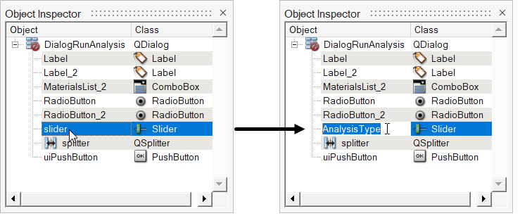

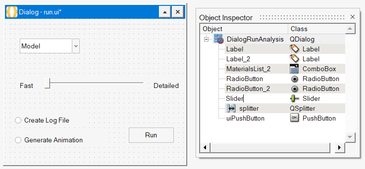

The example shows the name change for the Slider object from
Slider
to
AnalysisType
. Name changes are
also reflected in the code when the design is saved as
an OML file.
