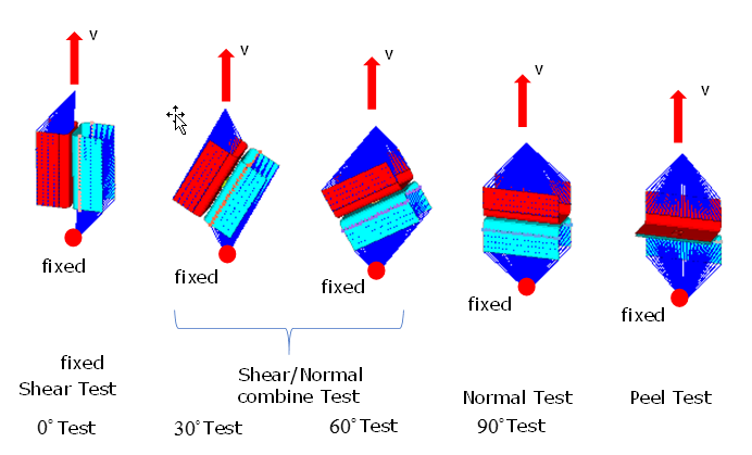

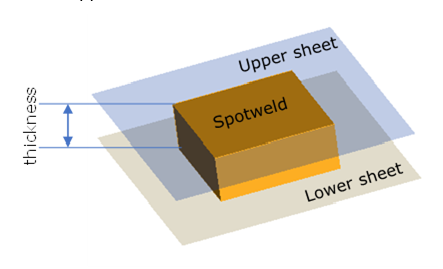

The spotweld is represented by one solid element connected the upper and lower sheets using a tied contact.
- Shear test (angle of load and sheet is 0°, below also named with 0° test)
- Normal test (90° test)
- Shear and normal combined tests (30° and 90° tests)
- Peel test

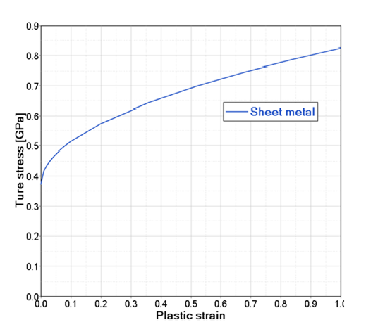

- Material Properties
- Initial density
- 7.85e-6 [Kg/mm3]
- Young's modulus
- 210 [GPa]
- Poisson ratio
- 0.3
- Yield stress
- 0.370 [GPa]

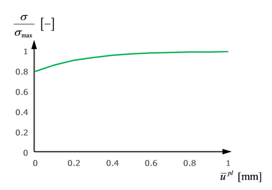

- Yield curve, fct_ID1

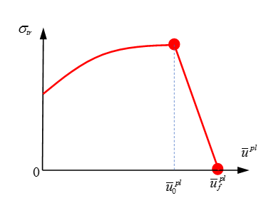

- Maximum stress in normal and shear direction with
- Maximum stress for loads that combine normal and shear loading
- Maximum stress in moment (peel test)
- and in normal and shear direction with (fct_ID0S), (fct_IDFS), (fct_ID0N), and (fct_IDFN)

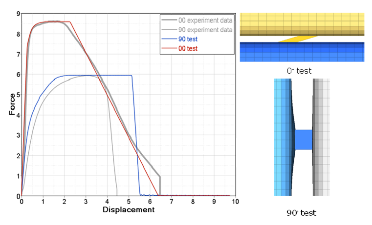

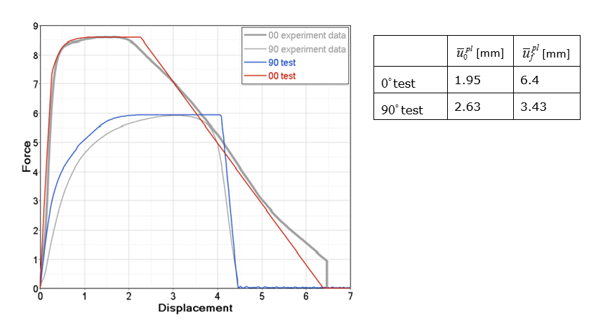

The maximum stress in the normal direction and in tangent direction is extracted from the 90° test and 0° shear test and input as in LAW83.

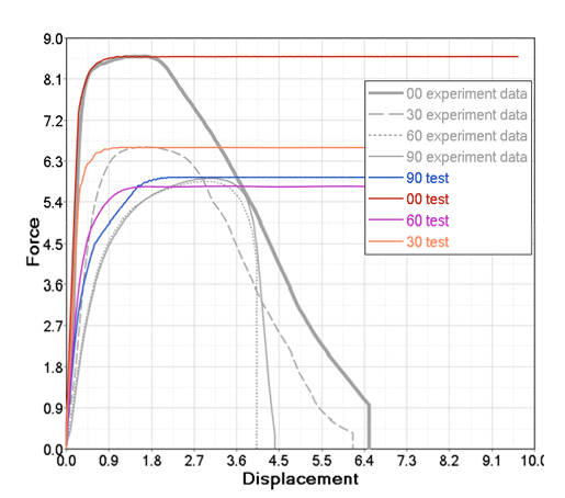

- Spotweld failure in 90° (normal) and 0° (shear) testInput the displacement where damage begins and displacement at failure from the 90° test into functions ( (fct_ID0N) and ( (fct_IDFN) and from test into functions ( (fct_ID0S) and (fct_IDFS). Since there is no rate effect data, the curves will be constant.Using these values in a simulation, the beginning damage displacement and failure displacement match very well to the 0° test results. However, the simulation does not match very well to the 90° test. This is due to the deformation of upper and lower sheet metal. In the 0° test, the sheet metal barely deforms.Using the displacement of the sheet metal from the simulation results, the sheet metal displacement is subtracted from the and of the 90° test. After doing this, the force displacement curves in the simulation match the test.

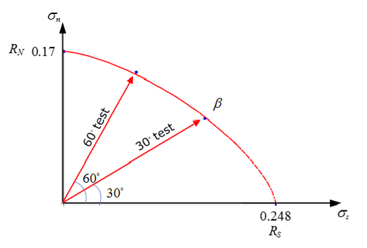

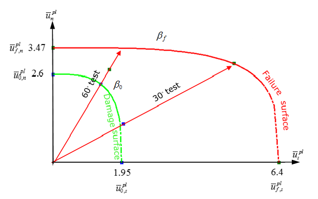

- Spotweld Failure in Combined TestsThe beginning and failure damage in the 30° and 60° tests (combined normal and shear loading) can be defined using the parameters in the following equations, which do not consider which are for peel test.
(4) (5) Taking and from experiment data:Using the results from the 30° and 60° tests, the and values are calculated using an equation fitting routine.Using the calculated fitted parameters , the simulation shows that the start of the damage does not match the experimental data. Similar to the 90° test, the deformation of sheet metal needs to be excluded from the damage displacements. The sheet metal displacement from the simulation is subtracted from the damage displacement and new parameters and are calculated using the fitting algorithm.Using the updated parameters, the beginning of the damage better matches the experiment data.

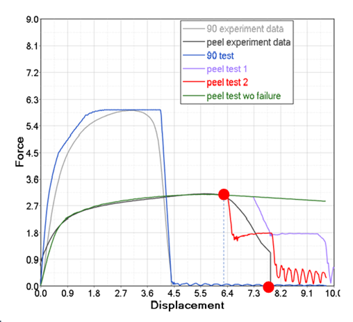

- Spotweld Failure in Peel Test
To correctly simulate the moment loads that occur in the peel test, the scale factor parameters must be calculated.
If the shear terms are ignored, the beginning and failure damage is represented as:(6) (7) The and terms scale the normal term in the equation. As done before for LAW83, the terms can be determined using the simulation and optimization or trial and error to match the peel test results. Starting with and the knowledge that increasing these terms decreases the and values, you determine that the parameters (peel test 2) result in and values that match the experimental peel test data.
