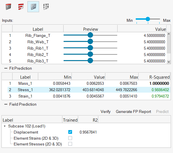

Click the Trade Off tool .
The Trade Off panel opens.The Trade-off panel is divided into three areas:
- Inputs
- Each row in the Inputs area corresponds to an input or design variable in the exploration. Moving the sliders, or keying in values in the Value column, sets the desired value for the given design variable.
- Fit Prediction
- Predicted response values are shown based on a response surface fit automatically generated for every DOE.
- Field Prediction
- Using advanced machine learning techniques, predicted results are calculated and contoured for the entire model.
In the Field Prediction area, select Displacement and
click Predict.
An animation client window opens with predicted displacement results contoured.
In the Inputs area, move the design variables sliders (or key in values in the
Value column).
The predicted results contour is updated accordingly, displaying predicted results in real time.
In the Field Prediction area, right-click on Element Stresses (2D
& 3D) and select Train.
The Element Stress results are trained.
In the Field Prediction area, select Element Stresses (2D &
3D) and click Predict.
The animation client displaying the predicted results is contoured with predicted stress results.
Value column).
