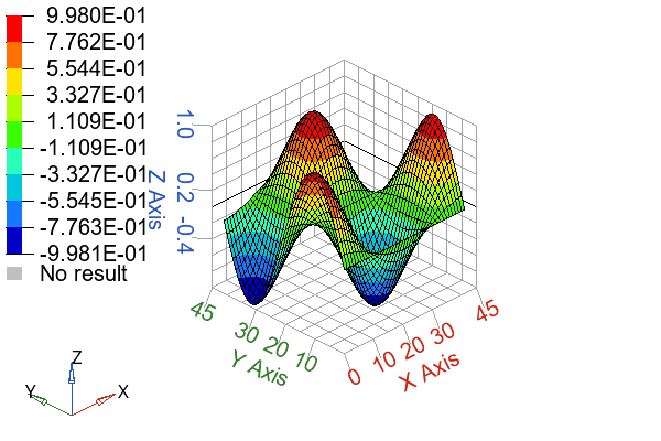

contour3 plot example:
cla;
x=[0:0.15:2*pi];
y=x;
z=sin(x')*cos(y);
contour3(z);
colorbar;
Figure 1. 3D contour plot
