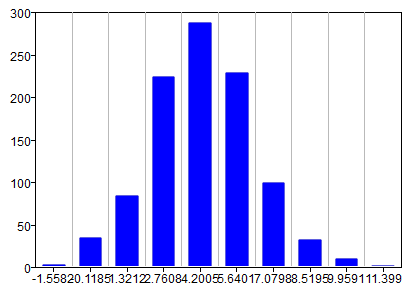

Example
Simple hist example:
clf;
d=normrnd(5,2,1,1000);
hist(d);
Figure 1. Hist plot
hist example with a return value:
clf;
[nums, xs]=hist(d);
bar(xs, nums);
Figure 2. hist with return value
