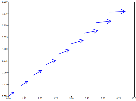

Examples
Simple quiver plot example:
clf;
u = linspace(1,3,9);
v = sin(linspace(1, 3, 9));
qh = quiver(0:8, 0:8, u,v);
axis([0 10 0 9]);
Figure 1. Simple quiver plot

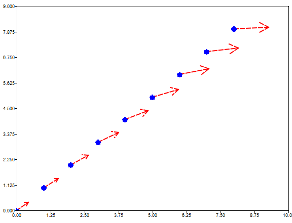

quiver plot style:
clf;
axis([0 10 0 9]);
set(qh, 'color', 'r')
set(qh, 'linestyle', '--')
set(qh, 'marker', 'o')
Figure 2. quiver plot style

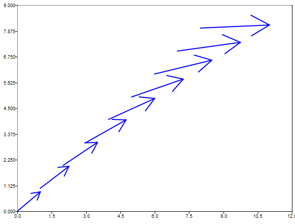

quiver plot with autoscaling disabled:
clf;
axis([0 12 0 9]);
set(qh,'autoscale','off');
Figure 3. Vector autoscale 'off'

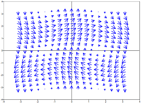

Scale arrow head:
clf;
[x, y] = meshgrid(-pi:pi/8:pi, -pi:pi/8:pi);
u = sin(y);
v = cos(x);
qh = quiver(x,y,u,v);
set(qh,'maxheadsize',0.9)
Figure 4. Arrow head size set to 0.9
