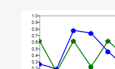

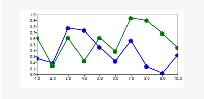

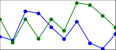

figure(1, 'position',[0 0 500 300]);
undock;
plot(rand(10,2),'-o');
set(gca,'position',[0.1 0.1 0.8 0.8]);
% capture figure
im1 = getframe(1);
% capture axes
im2 = getframe(gca);
% capture a part of the figure
im3 = getframe(1,[1 1 250 150]);
Figure 1. Capture figure
