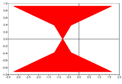

2D patch plot example:
clf;
t1 = (1/16:1/8:1) * 2*pi;
t2 = ((1/16:1/8:1) + 1/32) * 2*pi;
x = tan (t1) - 0.8;
y = sin (t1);
h = patch (x',y','r')
Figure 1. 2D patch plot example

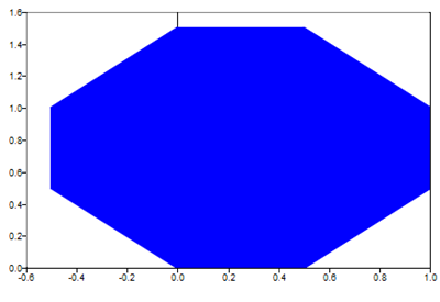

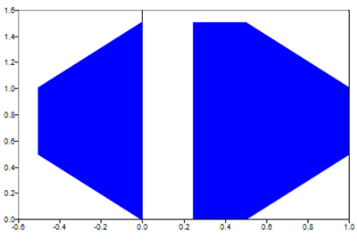

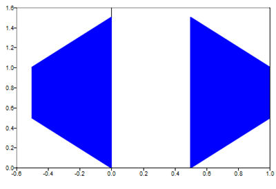

2D patch plot defined by vertices and faces matrices examples:
x = [0 0.25 0.5 1 1 0.5 0.25 0 -0.5 -0.5]';
y = [0 0 0 0.5 1 1.5 1.5 1.5 1 0.5]';
verts = [x, y];
figure(1);
% Create one patch which constinst of 10 vertices
faces = [1:10];
h = patch('vertices',verts,'faces',faces);
figure(2);
% Create two patches each one consisting of 4 vertices
faces = [3 4 5 6; 8 9 10 1];
figure(3);
% Create two patches, the first patch consists of 6 vertices,
% the second patch consists of 4 vertices
faces = [2 3 4 5 6 7; 8 9 10 1 NaN NaN];
Figure 2. 2D patch plot defined by vertices and faces matrices
Figure 3. Create two-2D patches defined by vertices and faces matrices
Figure 4. Create two-2D patches that have different number of vertices

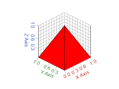

Example of 3D patch plot. Patch faces are triangles:
clf;
x = [0 1 1 0; 1 1 0 0; 0.5 0.5 0.5 0.5];
y = [0 0 1 1; 0 1 1 0; 0.5 0.5 0.5 0.5];
z = [0 0 0 0; 0 0 0 0; 1 1 1 1];
h = patch(x,y,z,'r');
Figure 5. 3D patch plot example - triangles

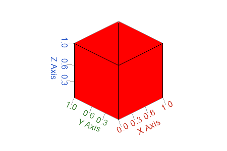

Example of 3D patch plot. Patch faces are quads:
clf;
x = [0 1 1 0; 1 1 0 0; 1 1 0 0; 0 1 1 0];
y = [0 0 1 1; 0 1 1 0; 0 1 1 0; 0 0 1 1];
z = [0 0 0 0; 0 0 0 0; 1 1 1 1; 1 1 1 1];
Figure 6. 3D patch plot example - quads

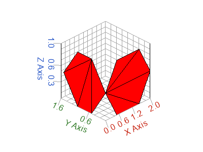

Example of 3D patch plot. Patch faces are polygons, triangulation is performed:
clf;
x = [0.5 0; 1.5 0; 2 0; 1.5, 0; 0.5 0; 0 0];
y = [0 0; 0 0.5; 0 1; 0 1.5; 0 1; 0 0.5];
z = [0 0.5; 0 0; 0.5 0; 1 0.5; 1 1; 0.5 1];
Figure 7. 3D patch plot example - polygons

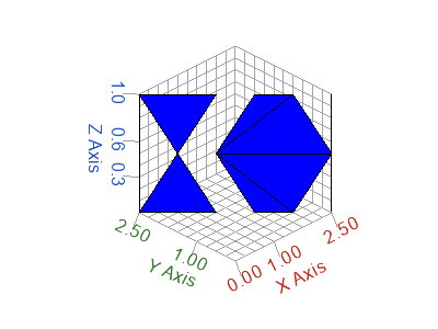

Example of 3D patch plot defined by vertices and faces matrices:
clf;
verts = [0 2.5 0; 1 1.5 0; 1.5 1 0;   2 0.5 0; 2.5 0, 0.5; 2 0.5 1;
          1.5, 1 1; 1 1.5 0.5; 1 1.5 1; 0 2.5 1; 0.5 2 0.5];
faces = [1 2 11 NaN NaN NaN; 9 10 11 NaN NaN NaN; 3 4 5 6 7 8];
Figure 8. 3D patch plot defined by vertices and faces matrices
