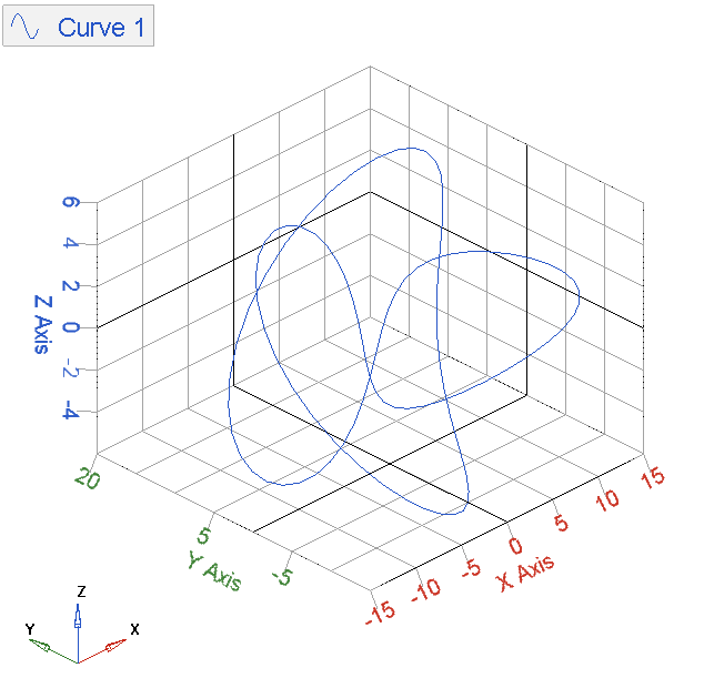

Example
Simple plot3 example:
clf;
u = [0:(pi/50):(2*pi)];
x = sin(2*u).*(10.0 + 6*cos(3*u));
y = cos(2*u).*(10.0 + 6*cos(3*u));
z = 6*sin(3*u);
plot3(x,y,z)
Figure 1. Plot3 plot
