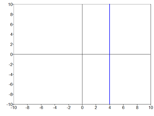

Simple xline example:
clf;
      		h = xline(4);
Figure 1. Vertical line at x = 4

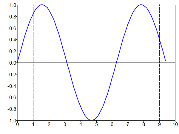

Create vertical lines and set properties example:
clf;
          	x=[0:0.1:3*pi];
			plot(x, sin(x));
			h = xline([1;9],'color','k','linestyle','--');
Figure 2. Create 2 lines and set properties
