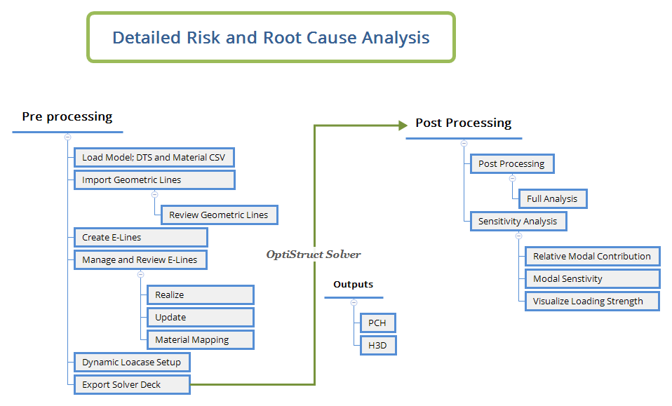

Figure 1. Workflow- ...\hwdesktop\demos\snr\001_model: Contains the model and geometric lines file.
- ...\hwdesktop\demos\snr\002_dts_and_material_data: Contains the DTS and material data file.
- ...\hwdesktop\demos\snr\003_loads: Contains the load definition files.

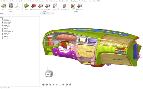

Import Model, DTS, and Material File
In this step, you will use the Import tool to import the required files.

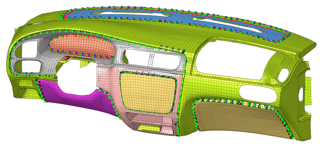

Create E-Lines
In this step, you will use the Create E-Lines tool to create E-Lines at the interfaces.
| Method | Line Type | Gap Direction | Main Component | Secondary Component | Interface Name |
| Fast | Rattle | In plane to Main | IP Substrate | Glove Box | GloveBox_To_IPsubstrate |
| Fast | Squeak | In plane to Main | IP Substrate | Dashboard Panel | Ipsubstrate_To_Dashboardpanel |
| Manual | Rattle | In plane to Main | IP Substrate | Control Panel Upper | IPsubstrate_To_ControlpanelUpper |
| Manual | Rattle | Normal to Main | Radio Panel | Lower Control Panel | Radiopanel_To_ControlPanelLower |
| Manual | Rattle | In plane to Main | Driver Side Panel | Lower Control Panel | DriverSidepanel_To_Controlpanellower |
| Manual | Rattle | In plane to Main | Driver Side Panel | IP Substrate | DriverSidepanel_To_IPsubstrate |
| Manual | Rattle | In plane to Main | Lower Control Panel | IP Substrate | IPsubstrate_To_Controlpanellower |
| Manual | Squeak | Normal to Main | Speedometer | Control Panel Upper | Speedometer_To_ControlPanelUpper |
Fast create E-Lines.
Manually create E-Lines.

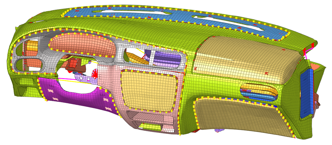

Figure 8. Realize E-Lines
In this step, you will use the Manage E-Lines tool to realize all E-Lines.

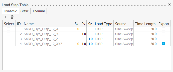

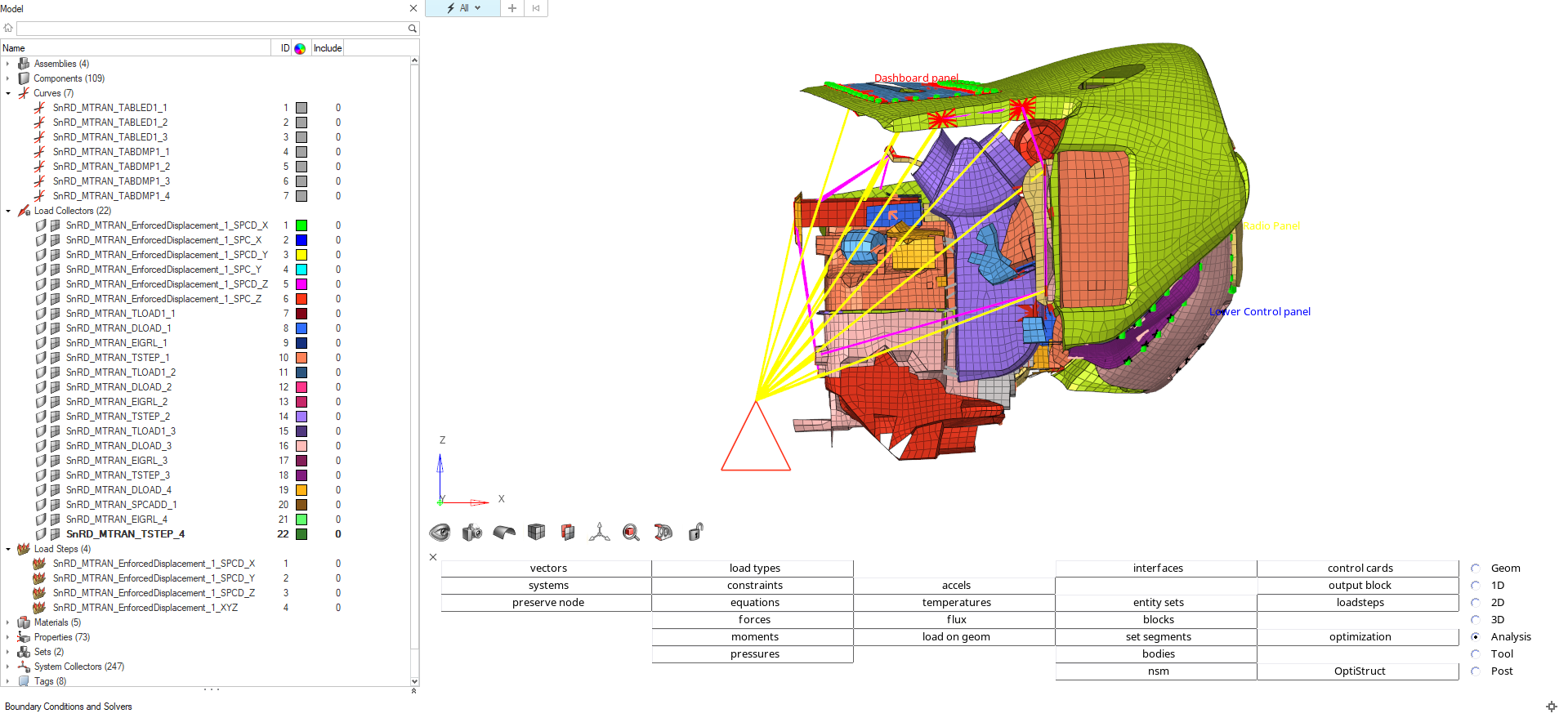

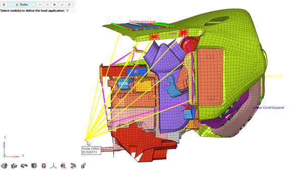

Define Dynamic Loadcase
In this step, you will create a Dynamic loadcase.
Review Loadcase and Export Solver Deck
Review the Dynamic Loadcase.

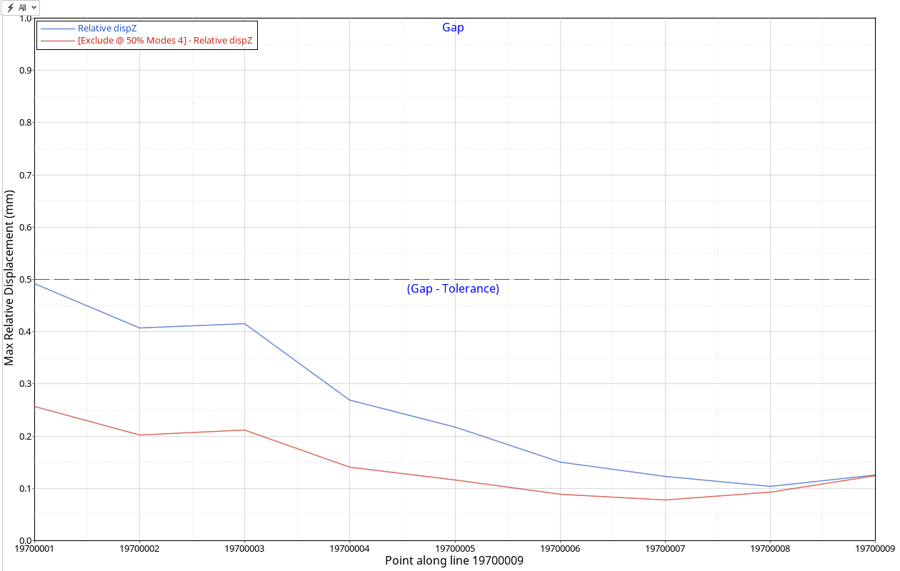

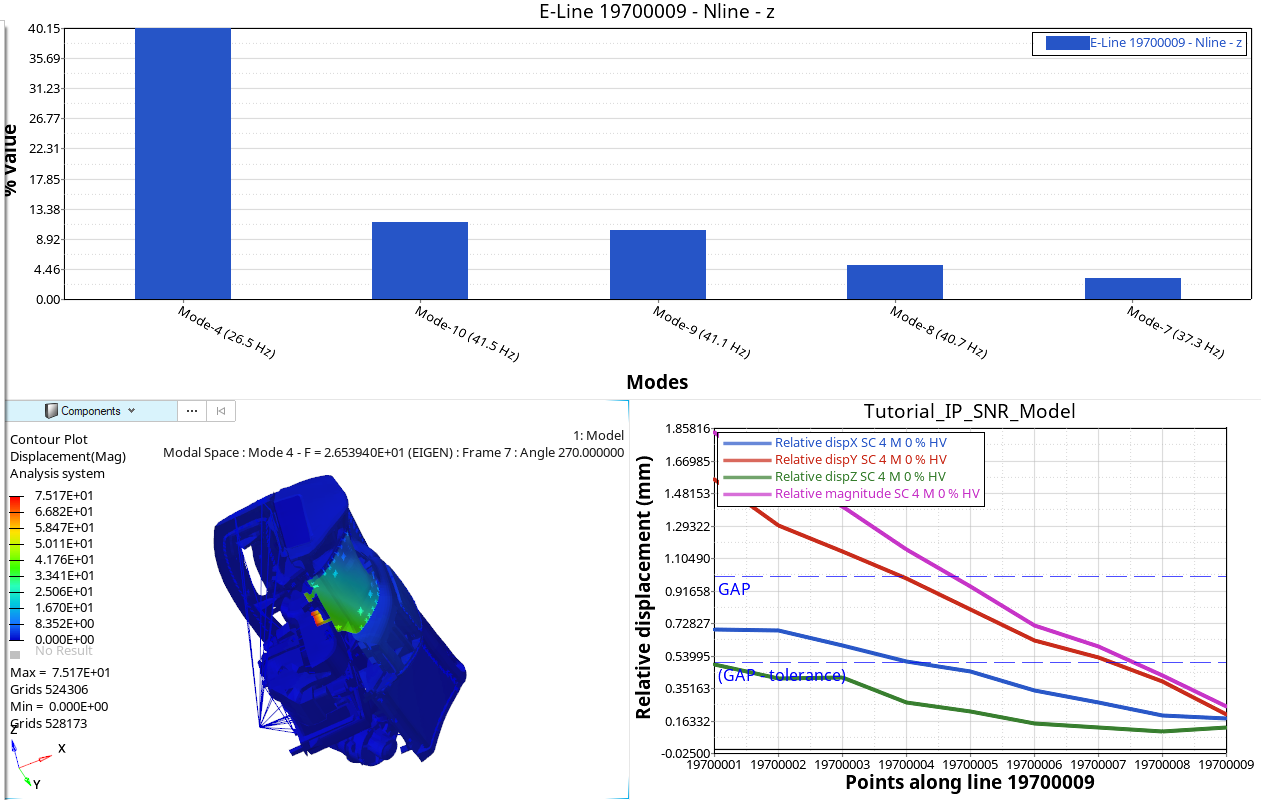

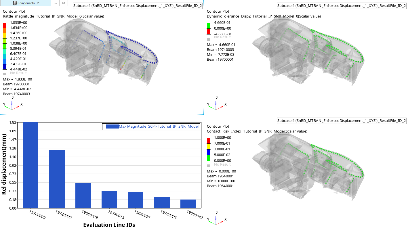

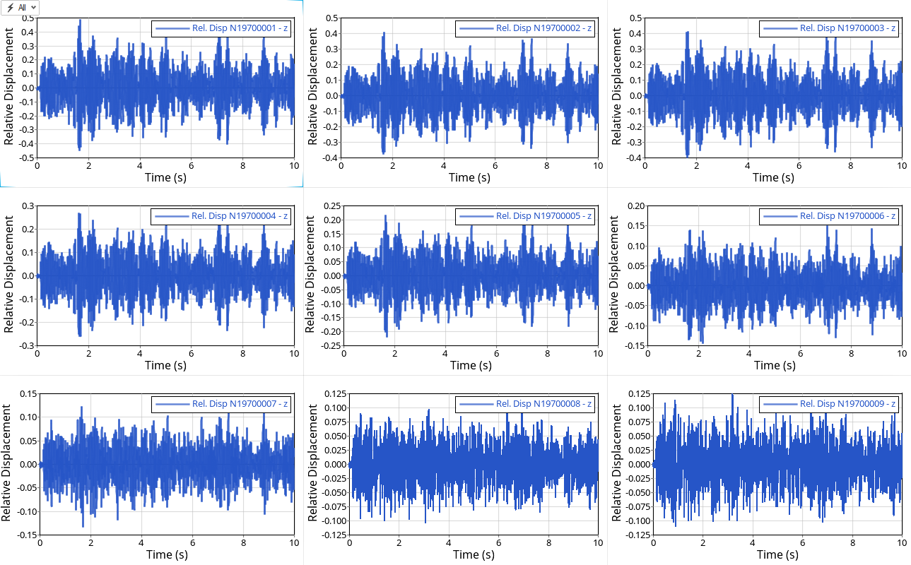

Post Process Results
In this step, you will perform a Full Analysis to understand the Squeak and Rattle risks in the model.
Figure 25. Rattle Summary Dynamic
Figure 26. Squeak Summary DynamicEvaluate Results

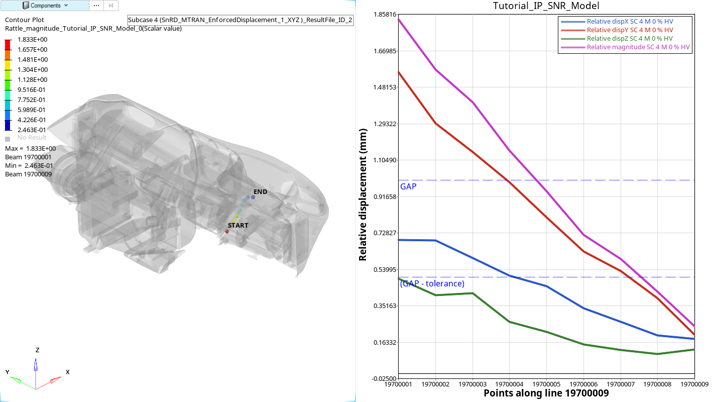

In this step, you will study the histograms and contour plots to understand results and complete Squeak and Rattle risk evaluation.
