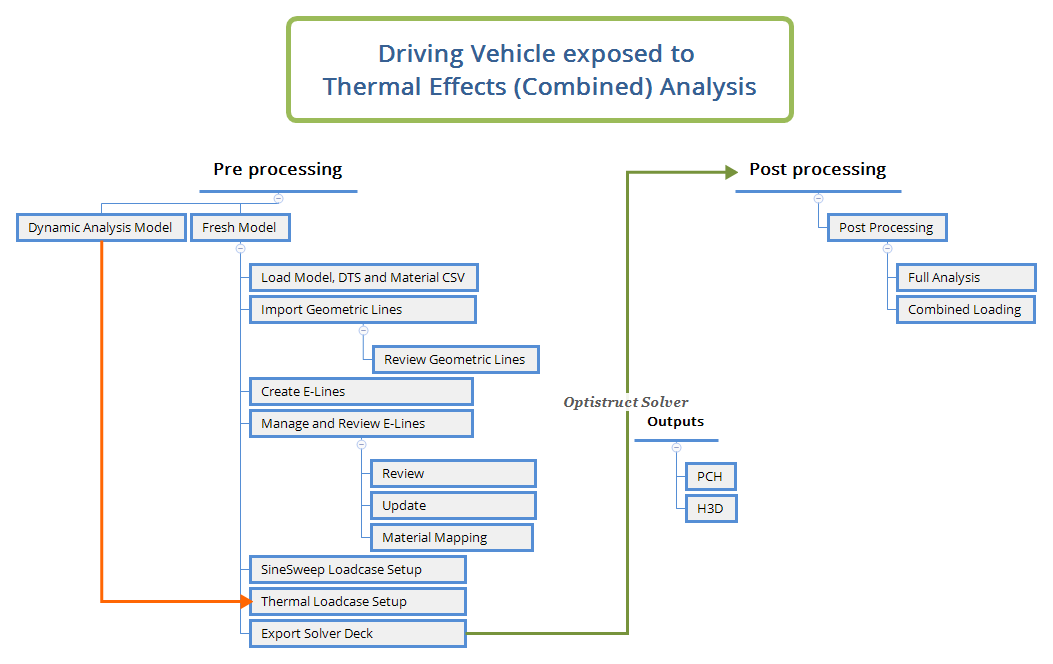

To answer this question, vibration loads responses (Dynamics) need to be superposed to the temperature effect on parts (Thermal Expansion – Static), gaps are reduced for example. In this workflow, the user will evaluate the squeak and rattle issues in a dynamic condition where the vehicle, in this case, a parked under sunlight with a spike in internal temperature (Static loadcase). Later the car is driven, which is exposed to Dynamic Loading. Below is the illustration of the Driving Vehicle exposed to the Thermal Effects (Combined Loading) workflow.

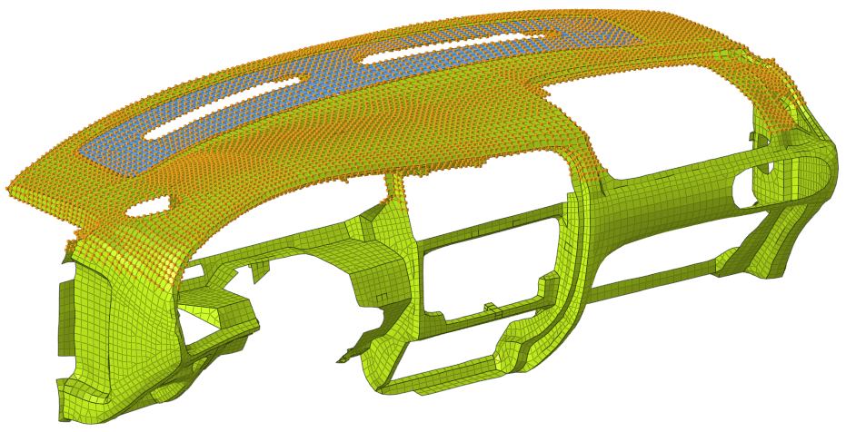

Figure 1. - Prepare the FE model for analyzing Squeak and Rattle issues.
- Apply a static load of amplitude -5.55 to the certain node(s) on Lower Control Panel component. This simulates a touch point scenario.
- Run analysis and post-process the results.

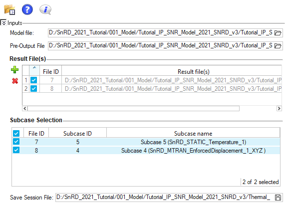

Import Model and Results File
In this step, you will use SnRD Post to post process the results.

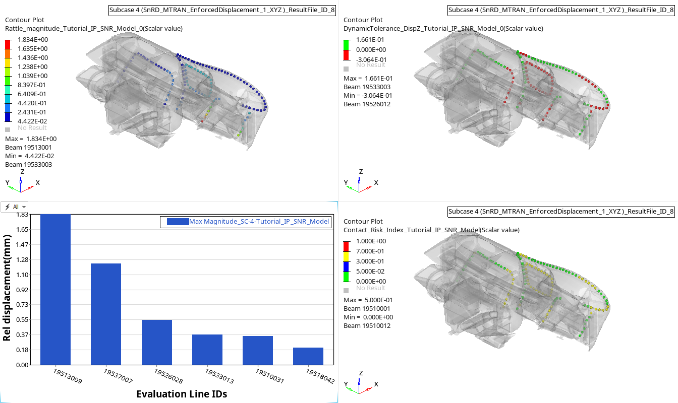

Post Processing
In this step, you will perform a Full Analysis to understand the Squeak and Rattle risks in the model.
Figure 11. Rattle Summary Dynamic
Figure 12. Squeak Summary Dynamic

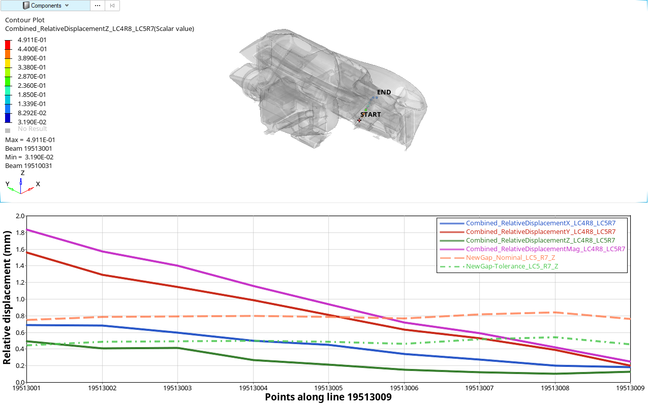

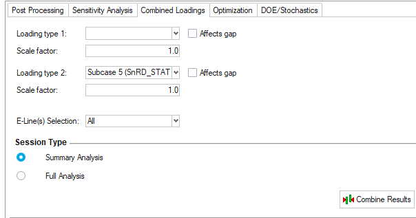

Figure 14. Squeak Summary ThermalCombined Loading
In this step, you will perform a Combined Loading study to understand the thermal effects on the squeak and rattle issues under Dynamic Loading condition.
