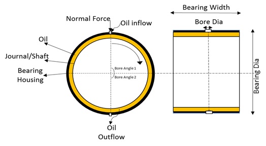

Journal Bearing with Bore:
The component simulates a steadily loaded rotating or pivot bearing in a typical engine lubrication system. Its main use is as a discharge element, which simulates lubricant fed to the bearing by a bore or bores, located at various positions relative to the applied loading. The model permits a choice of one or two bores, each of which is located at a user-defined angle to the displacement of the bearing caused by the load.
Fig: Journal Bearing with Bore

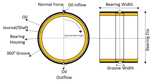

Journal Bearing with Groove:
The component simulates a steadily loaded rotating or pivot bearing in a typical engine lubrication system. Its main use is as a discharge element, which simulates lubricant fed to the bearing by a circumferential groove within the bearing shell. The model permits a choice of angular length and position of the groove.
Fig: Journal Bearing with Groove

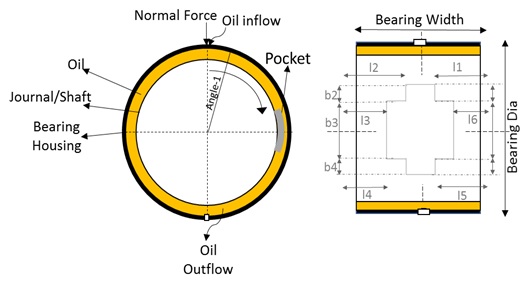

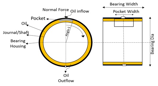

Journal Bearing with Pocket:
The component simulates a steadily loaded rotating or pivot bearing in a typical engine lubrication system. Its prime use is as a discharge element, which simulates a lubricant feed to the bearing by a pocket within the bearing shell. Pockets are modelled using equation from “Plain bearings - Hydrodynamic plain journal bearings under steady-state conditions - Part 1: Calculation of circular cylindrical bearings” DIN 31652. The model permits a choice of one or two pockets, each of which is located at a user-defined angle to the displacement of the bearing caused by the load.
Fig: Journal Bearing with Pocket

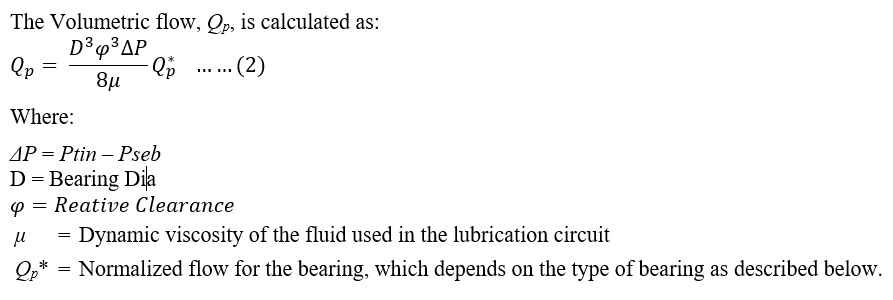

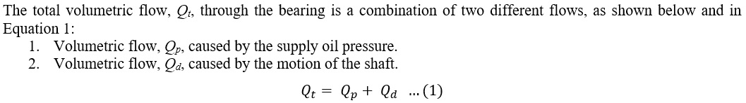

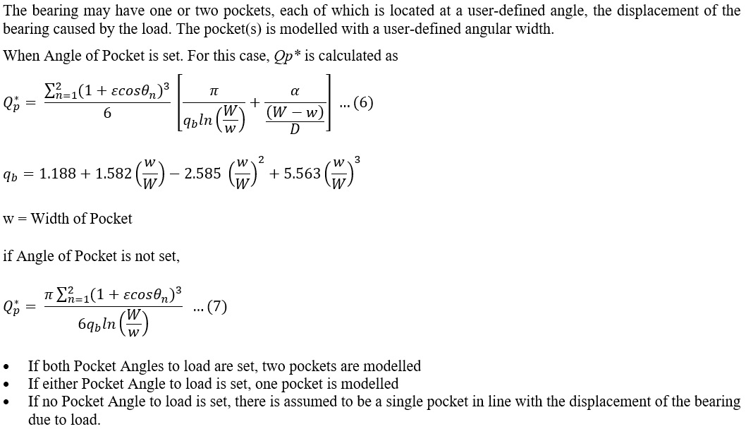

Volumetric Flow Caused by the Supply Oil Pressure
Journal bearing with Bore:

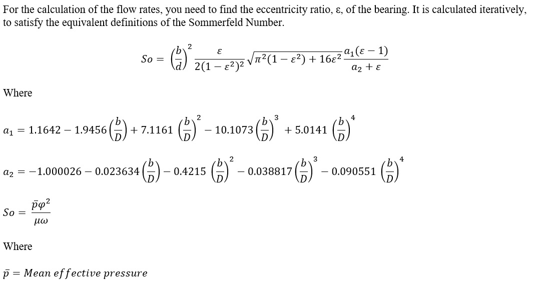

Journal bearing with Groove:
Journal Bearing with Special Pocket:

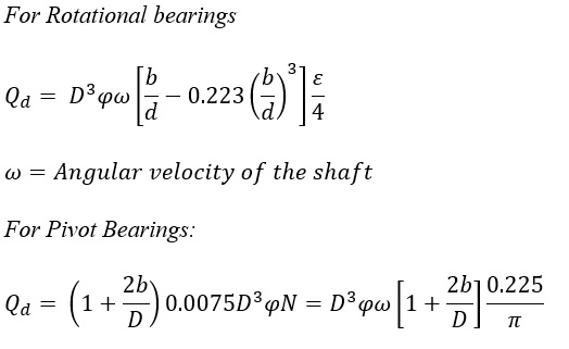

Volumetric Flow Caused by Shaft Motion

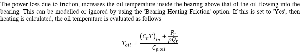

Exit Oil Temperature Prediction
Coefficient of Friction:
Friction Power:
Exit Oil Temperature:
