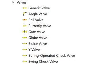

Flow Simulator has a range of control valves that can be used in Flow Network Modeling. They are as follows
- Generic Valve: This type of valve element is used to model valve types that are not supported directly.
- Angle Valve: Valve with its outlet opening oriented at right angles to its inlet opening.
- Ball-Valve: This valve type is form of quarter-turn valve which uses a hollow, perforated and pivoting ball to control flow through it
- Butterfly valve: Type of quarter turn valve. A quarter turn valve can open or close whenever the handle is turned 90 degrees (a quarter of a turn).
- Gate Valve: They are opened by lifting a barrier (gate) out of the path of the fluid.
- Globe Valve: These valve elements restrict the flow of fluid by altering the distance between a movable plug and a stationary seat.
- Sluice Valve: This valve element is operating like gate valves, a sluice valve operates in the either fully on or fully off position and is used to allow or stop, but not regulate, flow.
- Y Valve: This type of valve element can be used when the fluid flow required to be conveniently diverted. They are easily mounted to a bulkhead. The valves are operated by a simple 120° movement.
- Spring Operated Check Valve: these valve elements function in the same way as swing check valves, but they have a spring to stay closed when there is no flow in the correct direction. That means that as soon as fluid stops flowing through, the valve claps shut.
- Swing Check valve: A swing check valve is mounted with a disc that swings on a hinge or shaft. The disc swings off the seat to allow forward flow and when the flow is stopped, the disc swings back onto the seat to block reverse flow.

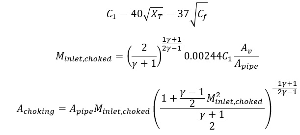

| 4 | Type of Compressible Gas Choking Correction Factor (GASFAC_MODE) |
Three types of compressible gas choking correction factor are supported: 0: Off 1: C1 (Gas Flow Factor) 2: XT (XT Factor) 3: Cf (Critical Flow Factor) |

| 9 | Compressible Gas Correction Factor Curve (GASFAC_CURVE) |
-1: User-Defined Gas Factor Curve in Table #2 0: Auto-select best gas factor curve based on VALVE_TYPE 11: Angle Valve C1 Curve from D.S. Miller’s Internal Flow Systems 2nd Ed. Fig. 7.20 21: Ball Valve C1 Curve from D.S. Miller’s Internal Flow Systems 2nd Ed. Fig. 7.20 31: Butterfly Valve C1 Curve (High) from D.S. Miller’s Internal Flow Systems 2nd Ed. Fig. 14.19 Butterfly Valve K Curve A from D.S. Miller’s Internal Flow Systems 2nd Ed. Fig. 14.19 32: Butterfly Valve C1 Curve (Low) from D.S. Miller’s Internal Flow Systems 2nd Ed. Fig. 14.19 Butterfly Valve K Curve A from D.S. Miller’s Internal Flow Systems 2nd Ed. Fig. 14.19 33: Butterfly Valve C1 Curve (Averaged) from D.S. Miller’s Internal Flow Systems 2nd Ed. Fig. 14.19 Butterfly Valve K Curve A from D.S. Miller’s Internal Flow Systems 2nd Ed. Fig. 14.19 51: Globe Valve C1 Curve from D.S. Miller’s Internal Flow Systems 2nd Ed. Fig. 7.20 |

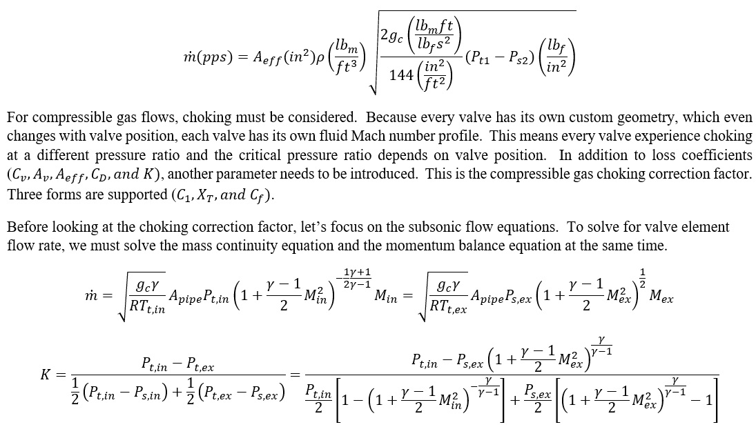

Mass Flow rate Calculation
The valve element routine simulates incompressible liquid or compressible gas flows. For incompressible liquid flows, we start by presenting the standard equation of a valve with its flow rate defined by the Cv coefficient.

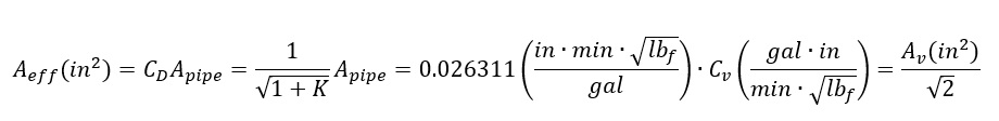

Since the Flow Simulator’s valve element supports other loss coefficient types, we were able to use the above equation together with standard incompressible loss coefficient conversions to make relate one form of loss coefficient to the others.
After conversion, the standard flow function is applied using effective area as the main driving loss parameter.

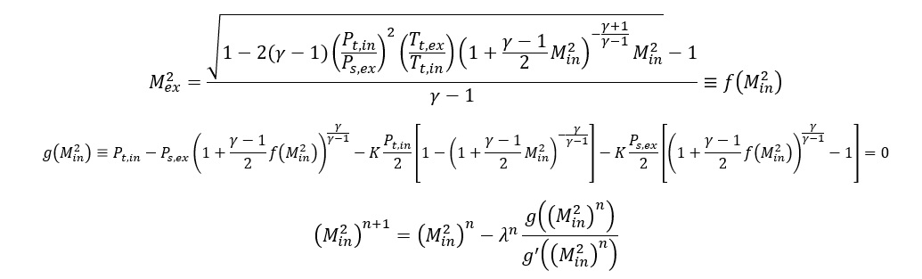

Rearranging the mass continuity equation yields the following function f, which
expresses exit Mach number in terms of inlet Mach number. Then f is inserted into
the momentum equation and the momentum equation is rearranged into a residual
function that must be driven to zero by changing inlet Mach number in order to reach
a converged solution. Finally, Newton’s method is applied to solve for inlet Mach
number. The method uses a relaxation parameter
that is generally equal to one (no relaxation) but drops
to 0.5 or lower if convergence is not reached with 20 iterations. Usually
convergence is attained in 1 to 4 iterations.

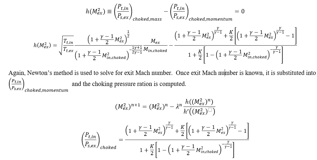

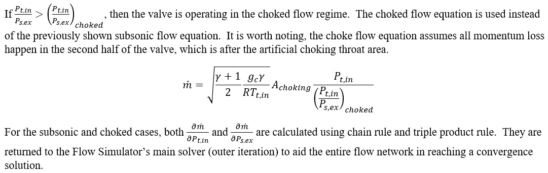

Once we know inlet Mach number, the continuity equation is used to solve for mass flow rate, exit Mach number, and all other previously unresolved velocity, static temperature, and pressure quantities at inlet and exit stations.
Before calculating subsonic flow rate however, we first need to decide in flow is in the choked regime. For valves, choking happens more easily than ideal flow channels, and this is where the choking correction factor and the semi-empirical choking area formula come into use.
Next, we re-introduce the mass continuity equation and the momentum balance equation. However, this time we rearrange and solve for pressure ratio and we substitute inlet Mach number that corresponds to choked at the artificial choking throat area.

| INLET_MACH_NEEDED_FOR_CHOKING |
Mach number at chocked flow. Used to determining whether flow is subsonic or choked |
| CALCULATED_RESTRICTION_AREA_AT_THROAT | Calculated Area for Choked Conditions ![]() |
inch, m |
Compressible Gas Correction Factors: C1= XT= CF= |
Compressible gas correction factors | (unitless) |

| AEFF_INPUT | Pipe Area * CD_INPUT | Inch2, m2 |
| CV_INPUT | Valve Flow Coefficient | |
| AV_INPUT | Flow coefficient | Inch2, m2 |
