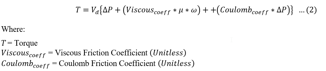

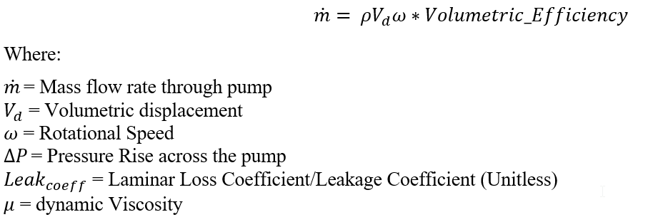

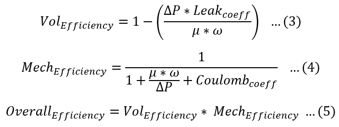

Mass Flow rate Calculation
The Flow rate for a give pump is given by
If Leakage Coefficient is provided
If Volumetric Efficiency is provided
Addition to this the efficiencies & torque across the pump is also calculated.
