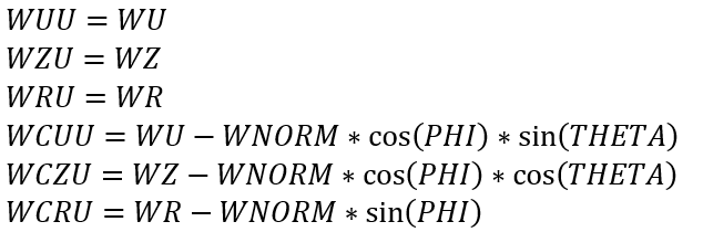

In Addition to the above the three components of the crossflow velocity where crossflow is defined as the component of velocity perpendicular to the axis of the element
WCUU: Magnitude of fluid tangential velocity relative to the rotational reference frame (i.e. rotor) at the element inlet perpendicular to the element axis
WCRU: Magnitude of fluid radial velocity at the element inlet perpendicular to the element axis
WCZU: Magnitude of fluid axial velocity at the element inlet perpendicular to the element axis
If the element angle variables are both zero (i.e. the element axis is parallel to the engine centerline) the calculated crossflow components will be the same as the corresponding relative velocity component. When crossflow effects are included in the analysis of flow through an element, the use of simple relative velocity components or the above crossflow components relative to the element axis will depend on the way the data used in developing the analytical method was correlated.

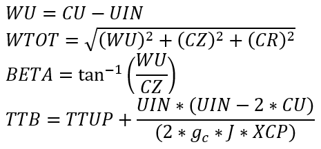

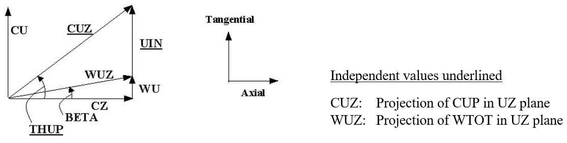

Upstream Inertial Chamber
The following definitions apply to the variables of concern:
CUP: Magnitude of upstream chamber absolute flow velocity
THUP: Upstream chamber absolute tangential flow angle
TTUP: Upstream inertial chamber absolute total temperature
UIN: Reference frame (i.e. rotor) tangential velocity at the element inlet radius
WTOT: Magnitude of the flow velocity relative to the rotational reference frame (i.e. rotor) at the element inlet
BETA: Tangential flow angle relative to the rotational reference frame (i.e. rotor) at the element inlet
TTB: Total temperature relative to the rotational reference frame (i.e. rotor) at the element inlet
CU: Magnitude of upstream chamber absolute tangential flow velocity
CZ: Magnitude of upstream chamber absolute axial flow velocity
CR: Magnitude of upstream chamber absolute radial flow velocity
WU Magnitude of tangential fluid velocity relative to the rotational reference frame (i.e. rotor) at the element inlet
If the upstream chamber is chamber IC, the upstream absolute values are obtained directly from the chamber state:
The element motion is entirely in the tangential direction, so the axial and radial relative velocity components are the same as their respective absolute components:
WZ=CZ
WR=CR
The reference frame (i.e. rotor) tangential velocity at the element inlet is calculated as
UIN=2π(RI/12)(RPMEL/60)
RPMEL: Input element rotational speed (rev/min)
RI: Radius from the engine centerline to the element inlet (in)
Based on the vector diagram shown below and making use of the Euler equation for the total relative fluid temperature, the remaining variables are calculated according to the equations:

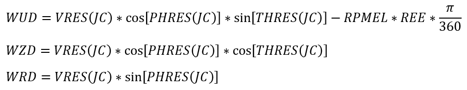

JC: Downstream Chamber
By definition, PSEB is simply the static pressure in the downstream:
PSEB=PSC(JC)
The downstream relative velocity and crossflow velocity terms are calculated in a manner similar to but much less involved than that used to calculate the upstream terms. For a downstream Momentum chamber, the downstream chamber Mach number is converted to a velocity using the Mach number function and values of and R obtained from the properties routine at TTC(JC), PSC(JC) and FS(JC):
For a downstream Plenum chamber, WDN is zero by definition. Directional components of velocity are then calculated as:
For a downstream Inertial chamber, the procedure uses the downstream chamber velocity, subtracting the tangential velocity of the element at its exit to get the relative tangential component:
REE: Radius from the engine centerline to the element exit
Based on the orientation of the element’s axis, as specified by the element input variables THETA and PHI (THTELX and PHIELX for Tube and Orifice elements), the component of fluid velocity relative to the rotational reference frame (i.e. rotor) at the element exit in the direction of the element axis is calculated as:
The crossflow velocity terms are calculated from the velocity vectors already obtained as follows:

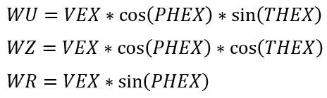

As stated previously, the purpose of the element routines is to calculate the element flow rate, the exit flow state and element flow derivatives with respect to up and downstream pressure. The exit flow state defines the velocity, direction and temperature of the flow entering the downstream chamber from the element.
The exit flow state variables are all expressed in the coordinate reference frame of the chamber. The reference frame of inertial chambers is always absolute (stationary). In all other situations, the reference frame assumed for the chamber depends on the element for which the calculations are being made. If the element has no provision for rotation (i.e. no input for RPM and radius from the engine centerline) or the rotational speed of the element is set to zero, the downstream chamber is assumed to have the same rotational speed as the upstream chamber. For all other element types, the reference frame is assumed to be rotating at the primary rotor speed supplied for the element (i.e. if the element is a seal with two RPM input variables, the one defined by RPMSELR is used). Because a momentum or plenum chamber may have a number of elements connected to it, it is important that they all are referenced to the same rotational speed if consistent results are to be achieved. If they are not, the flows entering the chamber will be balanced out by Flow Simulator to satisfy continuity, but the temperatures and velocities supplied to recalculate the chamber conditions will be inconsistent. An inertial chamber must be used to connect elements with different rotational speeds.
While the element routines may or may not involve rotational effects, the routine for any element type is designed to return results with exit conditions expressed relative to a reference frame rotating with the element. The flow state quantities returned are the following:
SFE: Secondary fluid mass fraction of the element flow
TEX: Total temperature of the fluid relative to the rotational reference frame (i.e. rotor) at the element exit
PH: Radial flow angle at the element exit
THTA: Tangential flow angle relative to the rotational reference frame (i.e. rotor) at the element exit
VEX: Magnitude of the fluid velocity relative to the rotational reference frame (i.e. rotor) at the element exit

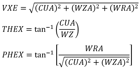

The variables required to be returned by the element routines to the Flow Simulator solver to specify the exit flow state are as defined in the section on ”Recalculating the Chamber State” If the downstream chamber is a Plenum or Momentum chamber, each of these variables will be as calculated by the element routine and the following equations for temperature, velocity and flow angles will apply:
TTE=TEX
VXE=VEX
PHEX=PH
THEX=THTA
Regardless of the existence of a downstream Inertial chamber FSE will remain unchanged.

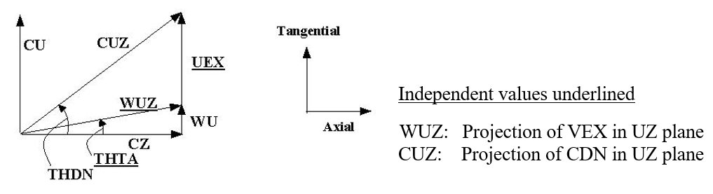

Any element that has a downstream inertial chamber requires calculation of the absolute flow state leaving the restriction. If the element is not rotating, the absolute flow state is the same as the relative flow state and no additional computation is needed. If the element is rotating, the quantities that must be computed are the temperature and the absolute velocity. The process used is the inverse of the process discussed in the section on “Computing Element Inlet Conditions”. The following vector diagram applies.
Figure:Velocity diagram for downstream absolute velocities
The first step is to calculate the three velocity components from the relative velocity and flow angles:
Since the relative motion is all due to rotation about the engine centerline, both WZ and WR are absolute as well as relative components of velocity.
Element rotational speed is the value input for the element, and UEX is calculated using the equation:
Whichever definition applies, the absolute tangential velocity is given by the equation:
CU=UEX+WU
and the absolute rotational velocity of the fluid becomes:
