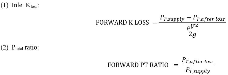

| 2 | Loss Option (LOSSFLAG) |
Total Pressure Loss Flag. Available loss options are: 0.0: No Pressure Loss 1.0: K-Loss Factor 2.0: Exit PT over Inlet PT
Note 1: Options 1 and 2 Include extra P total loss based on FWD_PLOSS and REV_PLOSS
Note 2: The Ptotal loss due to heat release is always calculated if temperature rises more than 1% through the element. |

Loss Calculation
