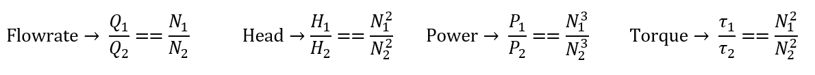

If the pump is rotating at its rated speed, then delta P is used to get the GPM and then the torque from the user supplied tables. If the pump is operating at off design conditions, then the Head & Toque curve are scaled. The pump homologous laws are used to correct head which is generated for a given pump speed and flow rate. The same logic is applied for a transient simulation where pump speed may vary. The laws state the following relationships for flow rate, head, power and torque with varying speed:
Where N = Speed, Q = Flow rate, H = Head, P = Power, τ = Torque
