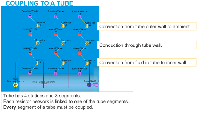

The tube element segments can also be associated with boundary temperature nodes. This allows complex networks of convector, conductor, and radiative resistors to be couple with the temperature of the tube flow.
