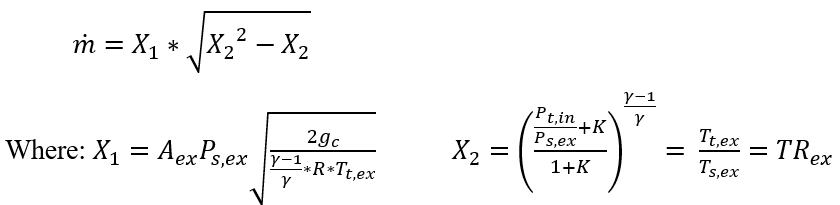

Flow Rate Calculations
These equations can be used to derive an expression for mass flow rate, .

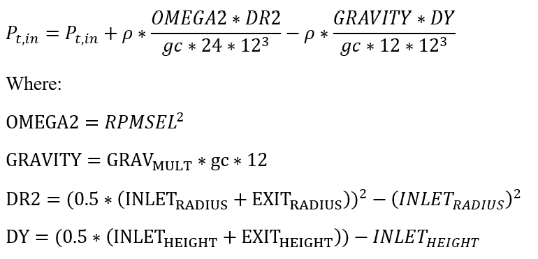

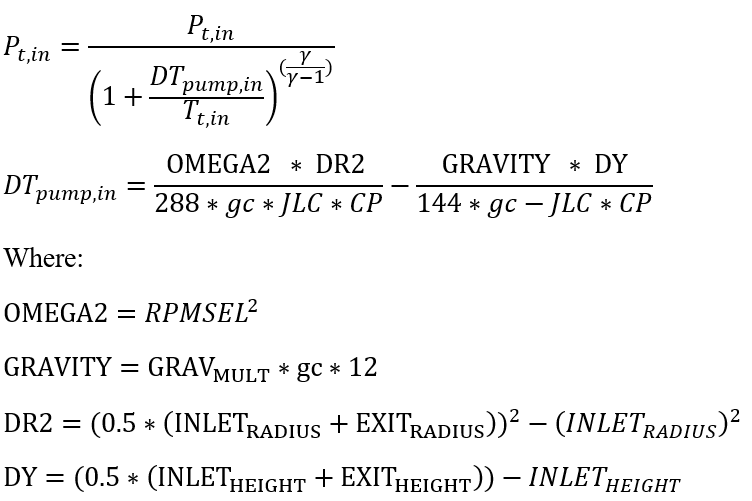

In the above equations, the corrected pressures (for the effects of Gravity & Pumping) will be used, which are defined below
Compressible and Incompressible Gas Conditions:
Inlet Conditions:

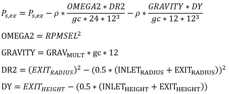

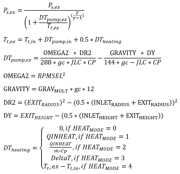

Exit Conditions:
Incompressible Liquid Conditions:
Inlet Conditions:
Exit Conditions:
