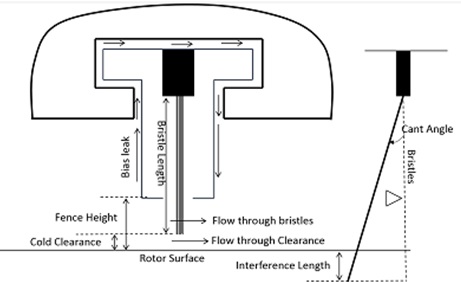

FlowSimulator Brush Seal element models the leakage flow across the W-Seal. This can be used only in Compressible (e.g. gas systems) analysis.
Figure: Brush Seal Inputs

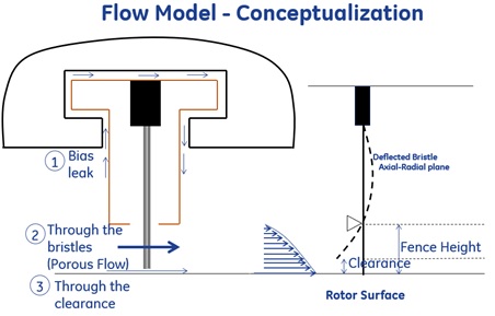

Assumptions
Porous Flow Model
- Flow is isothermal
- Losses due to radial flow across the bristles are not accounted
- Flow area is equal to back plate area exposed to the downstream only
- Bristle lift-off is modeled with coupling with the simplified one-dimensional deflection model
Tip clearance leak flow model
- Flow is incompressible through the clearance
- Bristles are treated to be equivalent of one tooth of lab-seal
- A constant CD = 0.6 is assumed by treated the gap as a sharp-edged orifice

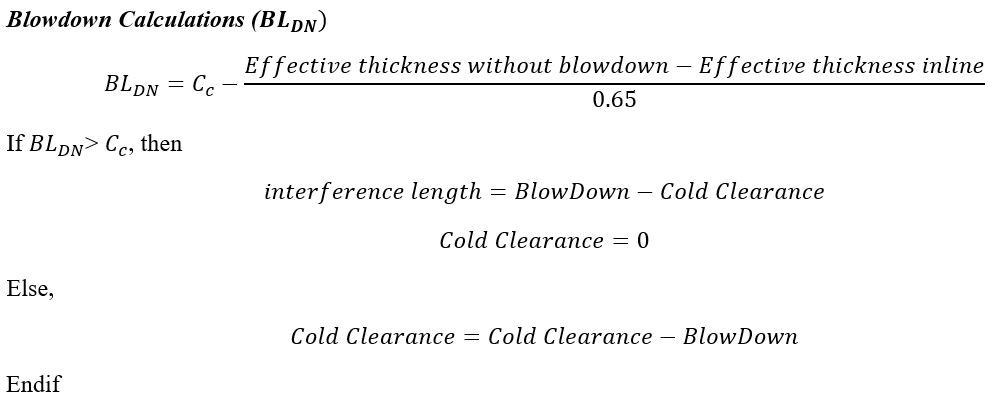

If (Cc=0) & (linter=0)→No Blow Down
If (Cc>0) & (linter=0)→Blow Down exixts
If (Cc=0) & (linter>0)→No Blow Down
If Blow Down exists, then
Calculate “Bristle Leak” through modified Chupp method with hf=0

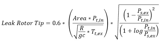

Calculate “Leak rotor Tip” through Alexiou /Yan/Orifice Formulation.
Calculate “Effective Thickness without Blowdown” for “Brush Leak = Bristle Leak + Leak rotor Tip” with hf=0
Calculate “Effective Thickness inline” for “Bristle Leak” with hf=0
Total Mass flow rate is W=Bristle Leak+Leak Rotor Tip

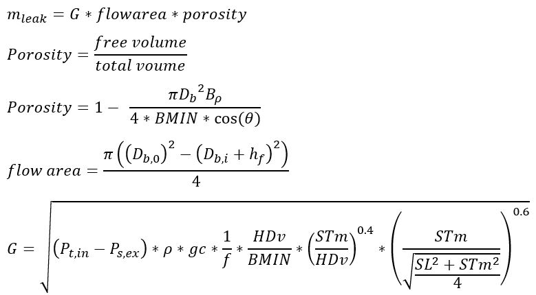

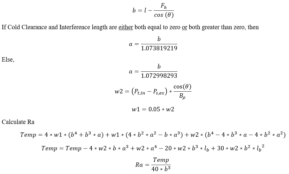

Flow through the Bristles (Porous Flow) Modified Chupp method

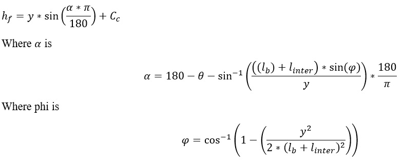

Clearance calculations – Axial (hf)
If (Clearance >=Fh), Clearance = Fh

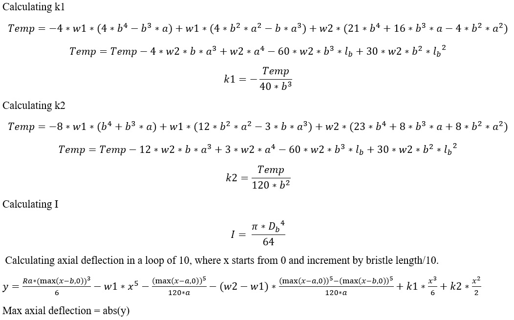

Max Axial Deflection(y)Calculation
Effective Thickness Calculation

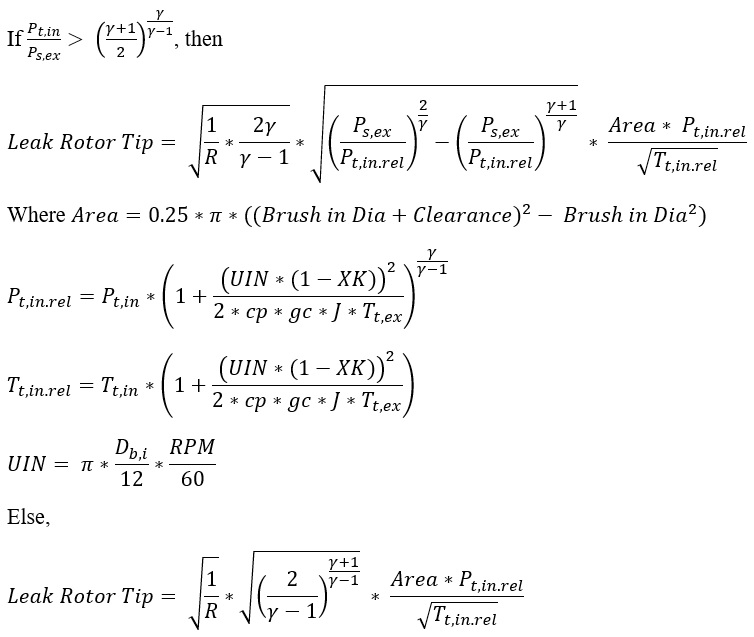

Flow Through the Rotor Tip Clearance Alexiou Model
Flow Through the Rotor Tip Clearance Orifice Equation
Flow Through the Rotor Tip Clearance Yans Formulation

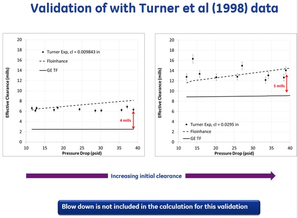

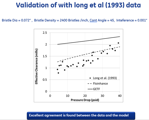

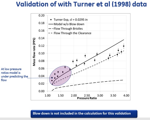

Validation
