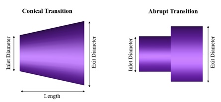

Transition Element General Description
There are two Flow Simulator transition elements available. Both can be used in compressible flow and incompressible flow simulations. This element is used to model various types of expansions (Ex: Flow through diffuser, Flow through an abrupt expansion) and contractions (Ex: Flow through reducers, Flow through a sudden contraction). These include abrupt and conical shaped as well as parameter inputs for defining the behavior of arbitrary shaped expansions and contractions.
Quick Guide for Transition Element Creation in the GUI
Both Conical & Abrupt Transitions can be found under both “Compressible Gas Elements” & “Incompressible Liquid Elements” - “Expansions & Contraction” section
The geometric inputs like inlet diameter, exit diameter and length are mandatory inputs. Apart from these, inputs related to friction are required if friction options are selected. Descriptions about each input is described below in “Transition Element Inputs” section.

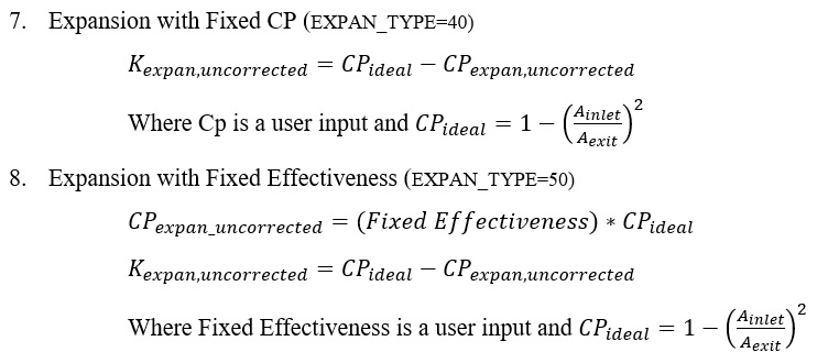

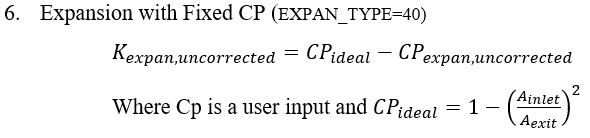

Expansion – Kloss Calculations
Expansion K is calculated differently based on the “Expansion Type” selected for the transition element. The K formulations for the different expansion types are outlined below.

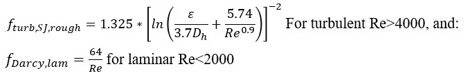

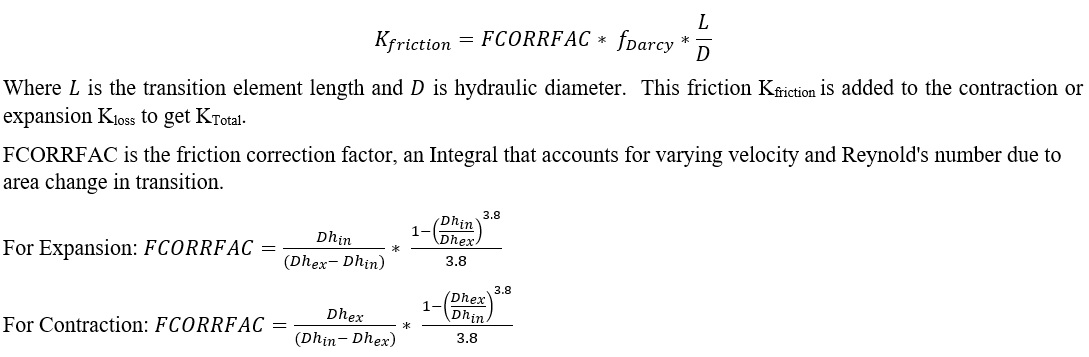

Friction Loss Calculations
The transition element currently supports friction coefficients for walls with specified surface roughness. There are two friction options:
- User-specified friction factor
- Swamee-Jain approximation of the Colebrook-White equation (Moody diagram) for wall Darcy friction factor as a function of Reynolds number:

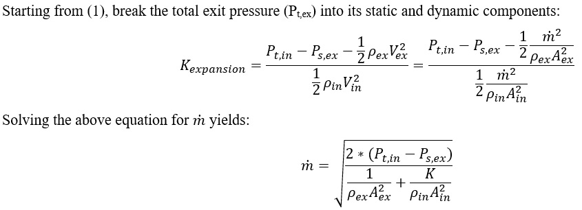

Flow Rate Calculations

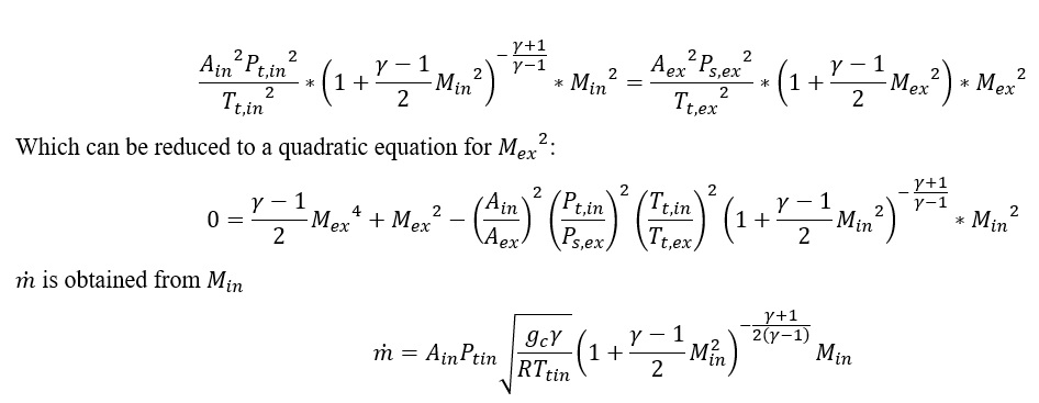

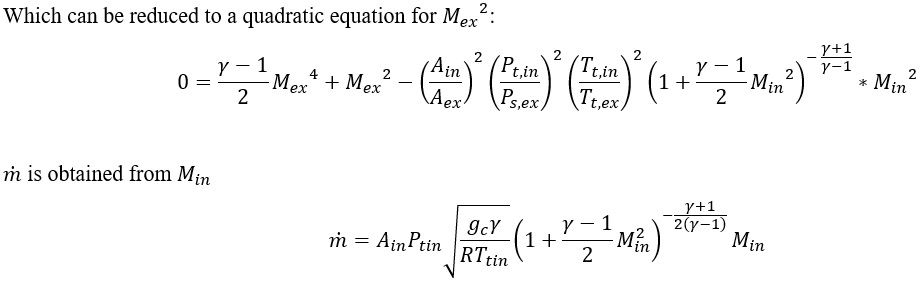

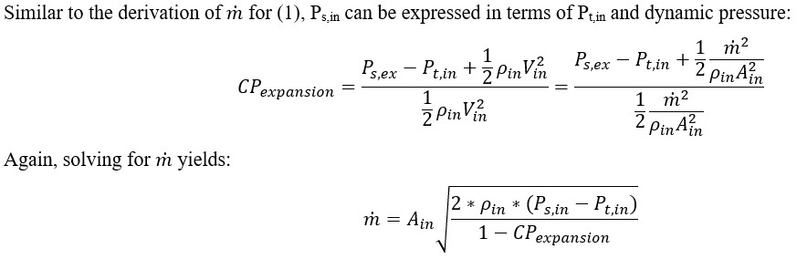

With the above in mind for how K (or Cp) is calculated for each of the transition
element types, the momentum equation for each of the possible cases is outlined in
the table 14 below. These equations can be used to derive an expression for mass
flow rate,
Formulation of
for (1) – Kexpansion for an
Incompressible Gas:
Formulation of
for (2) – CPexpansion for an
Incompressible Gas:
Formulation of
for (3) – Kcontraction for an
Incompressible Gas:

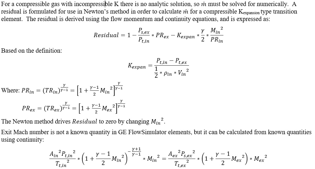

Formulation of
for (4) – Kexpansion for a Compressible
Gas:

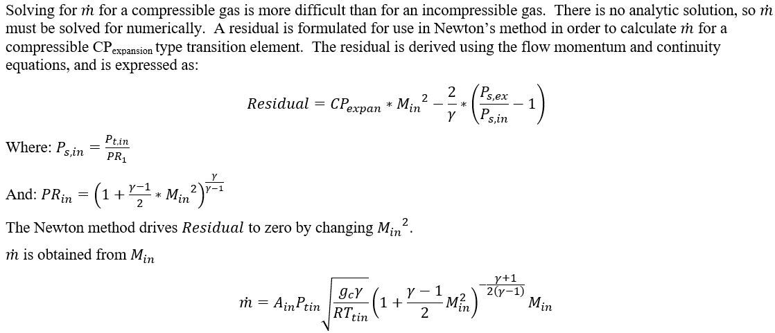

Formulation of
for (5) – CPexpansion for a Compressible
Gas:
Formulation of
for (6) – Kcontraction for a Compressible
Gas:
Formulation of
for (7) – Kexpansion for a Compressible
Gas with Compressible K:
Formulation of
for (8) – CPexpansion for a Compressible
Gas with Compressible CP:

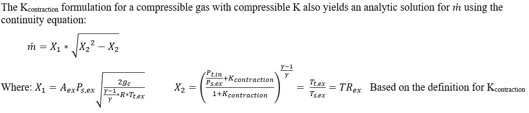

Formulation of
for (9) – Kcontraction for a Compressible
