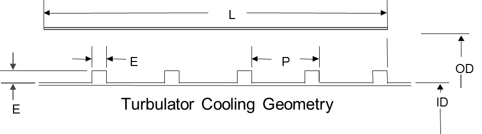

| 6 | Length (LENGTH) |
Short Passage Length Since friction losses a modelled as occurring at the exit, properties (area, velocity, pressure, etc.) should not vary too much from inlet to exit. Thus, the Short Passage is good for modeling small L/D channels. For longer L/D channels, the tube element is preferred. |

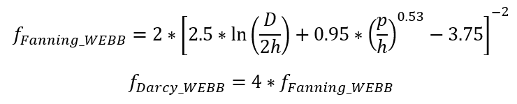

Webb formulation![]()
Rather than a fixed turbulator friction factor, the user may choose to use the Webb formulation for a Turbulated wall Fanning friction factor as a function of Reynolds number:
Where
h: the turbulator rib height (RIB_HEIGHT)
p: the turbulator rib pitch (RIB_PITCH)

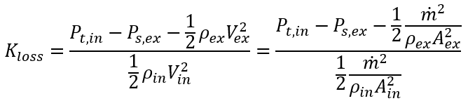

For Fixed Friction Coefficient:
Kloss Calculation:
From these formulations, the friction Kloss can be calculated from
Where L is the Turbulator passage length. This friction Kloss is added to any user-specified Kloss to get total Kloss.

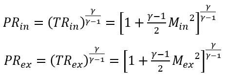

For a Compressible Gas:
For a compressible gas with incompressible K there is no analytic solution, so
must be solved for numerically. A
residual is formulated for use in Newton’s method in order to calculate
for a compressible Kexpansion
type transition element. The residual is derived using the flow momentum
and continuity equations, and is expressed as:
Based on the definition:
Where:
The Newton method drives Residual to zero by changing
Exit Mach number is not a known quantity in Flow Simulator elements, but it can be calculated from known quantities using continuity:
Which can be reduced to a quadratic equation for

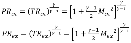

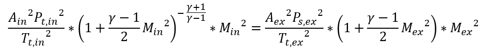

For a Fully Compressible Gas:
The Kloss formulation for a compressible gas with compressible K does
not yield an analytic solution for
. A residual is formulated for use in
for a compressible Kloss type
transition element. The residual is derived using the flow momentum and
Where:
Which can be reduced to a quadratic equation for :![]()
