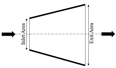

Static Pressure Recovery Coefficient (Cp). It is only used if FL_TBL_TYP is 0 (indicating a constant Cp is to be used).
| 3 | Inlet Area (IN_AREA) | Diffuser inlet area |
| 4 | Exit Area (EX_AREA) |
Diffuser exit area By definition EX_AREA should be greater than IN_AREA. |

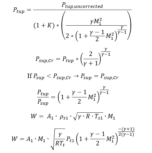

Calculation of Flow Rate
For Subtypes (1,2) the Mass flow rate through the diffuser is obtained as derived below,
If Effectiveness is provided (Subtype=2)
Static Pressure Upstream is calculated from as follows
The Upstream Total Pressure ( is corrected for inlet K Loss
