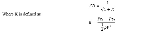

  • Provide the Incompressible Loss coefficient (K) as input. Allowable Kloss values are 0 to 10. The discharge coefficient is calculated by the incompressible relationship:

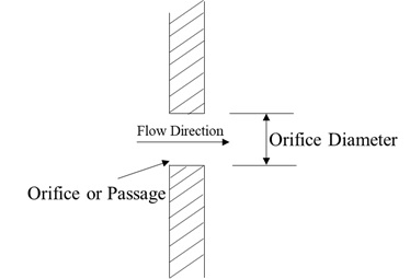

1 Area (AREA)
Diameter (DIA)
Orifice mechanical area
Orifice diameter

For all Subtypes, 0 < CD ≤ 1
For the conventional orifice, 0 ≤ K ≤ 10
For Discrete Loss, K ≥ 0

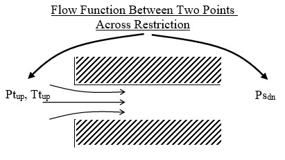

The isentropic flow function defines the flow through an orifice restriction in terms of upstream total pressure, upstream total temperature, downstream static pressure, and cross-sectional flow area. Since the flow function is derived with the assumption of isentropic flow, some sort of empirical correction is required to account for the irreversible losses encountered in the orifices. This is usually represented as a discharge coefficient or loss coefficient, included in the working definition of the flow function, and represents the ratio of actual (empirical) to ideal (isentropic) flow rates.
