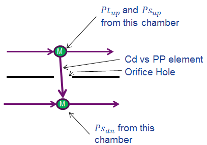

- Cd vs. Pressure Parameter
- Pressure Parameter table is defined as a dynamic head ratio between upstream and downstream flow.
